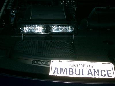

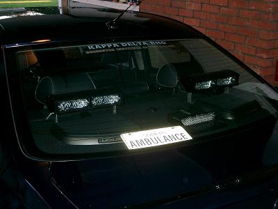

A more expensive alternative is to gut the whole thing and put either LIN6 or TIR6 LEDs. I'm a big fan of that:

[quote:cf6d7f7e38=\"Rob K\"]A more expensive alternative is to gut the whole thing and put either LIN6 or TIR6 LEDs. I'm a big fan of that:
Those modules slide right in to the channels in the housing w/o any adapter or anything?
If so, sweet, I have a TA housing that I might like to put some of those in.

[quote:5af0d0d935=\"101327\"]Those modules slide right in to the channels in the housing w/o any adapter or anything?
Correct.

how do you secure the lightheads after placing them inside the housing?
(talking of the tir6s/lin6s)

[quote:3939225e79=\"engine69\"]how do you secure the lightheads after placing them inside the housing?
The endcaps hold them in.
