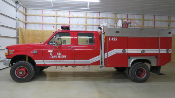

Our department just purchased a brush fire rig that came from a department in California. It is a 1997 model F450.
It has a Streethawk halogen bar on top. Basic bar with 3 rotators. The somewhat unique thing is, it has a single red steady burn on the driver's side. I've seen a lot of different bars with the CA Spec configuration, but never before a streethawk with just the one forward pod populated. All of the rest of the lower lighting locations are blank

Probably the most rudimentary way to make a StreetHawg CA compliant. Probably the cheapest as well..
I too have never seen the lowers totally blacked out on the front, are there lamp assemblies behind them, or just blanks?

We are going to upgrade all of the lighting to modern LED's, but I really like this bar and almost hate to remove it!
That big current sucking bar works really well, and I LIKE the lopsided steady burn!

Well, guys, you talked me into it. It's going to stay in service. I just spent most of the day restoring the domes (they weren't too bad to start with). I must say I am PROUD of the results, this thing looks about as close to new as you can get.
I had to hurry home from the station, I'll get some good pictures and video outside tomorrow.

I just updated the original post to include some outdoor pictures of the results. I am pleased. Can someone tell me how to post a video? I know I've done it before but can't seem to get them to upload?!?!?
I think it turned out great. You can upload a video to youtube, then post the youtube URL here.
The Streethawk was effective, that's for sure!

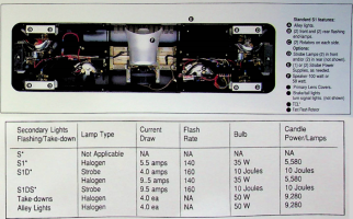

What was the factory steady burn option for federal on the streethawk? Both lowers steady?
It was which ever you selected. Initially when the base bar came out they made no mention of CA lights, although I know people had them. I have seen early examples of "speaker center bars" with a driver side red and a passenger side takedown, so it was possible but not mentioned in early catalogs. In the early 1990s they had some base models which did include dual CA lights, although they aren't the configs I actually have seen most frequently with CA lights. And you absolutely could "build your own" bar and get one take down or flasher or a blank like on the non-CA side this one.
Before the "all light" came out, the options were very basic. There was a CA option but it was not listed in the catalog.
1990 when there were base models with lower options (you could still custom order)

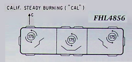

The specific bar in this thread is LOOKS LIKE a "firehawk" version from around 1999 (based on the fireray secondary strobes on the truck). However it is labeled streethawk, which wasn't uncommon as there was a lot of crossover and the firehawk came with a red base for a while so that might be factor. I have never seen the 3 rotator and cascade mirror setup offered as anything but a fire/EMS setup, so regardless of how it was labeled, it was a "base fire model" bar. These bars came with one of a few top configs and a blank bottom and you configured the bottom how you saw fit. This was true across all "hawks" at that point, but the fire ones were extra "lean" on the rotator count.
1999 firehawk options were top options only, you then specified the lower (and some other top) options. This is where the bar in this thread would fall time frame wise. It's possible with this bar that the 175fpm rotators were swapped for slower ones, I can't tell. You could still make changes to the top but most options were lower.
This is basically what is on the truck in the thread (again, they may have swapped in slower rotators though). FHL4856 plus a option CAL x1
Notice how the firehawk models all block the center (usually clear) section to the rear so there is no "clear to the rear" to comply with NFPA. The bar in this thread however does not, which is interesting and more argument that maybe it was ordered as a regular streethawk. Either way it had the basic firehawk 3 rotator setup. There was also an option (or at least they would do it on request) to use a half model 14 dome in amber or red to make a rear filter, but that wasn't ever an advertised option. Near the end of production the firehawk was the main version of streethawk offered as law enforcement was not generally using larger bars like the streethawk as much.

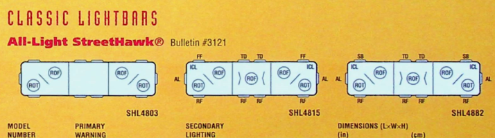

Here were your non-fire options around 1998/99. The bar was pretty much not being aimed at any "smaller markets".
