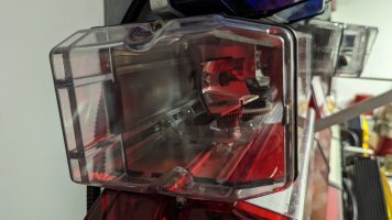

So my pierce alert has the typical heat damaged wiring and also has 1 burned out bulb. I am looking to rebuild it and rewire it.
Going to take it apart and polish the lens’ rewire and grease the gears. I have to keep this unique piece in good working order for the display.
The 27 watt bi-pin bulbs with the black tip are hard to find.
But looking at the wiring it appears the wires have a terminal crimped on the end of the wire to slide over the pin of the bulb. But what throws me off is the terminal looks to have some sort of locking device along with it.
Where can I find these pins?
And any sources of the super flexible wire that is used? Is it 16g silicone covered wire?

The little slide over locking terminals were used on all the "pin out the back' bulbs (early 4x4, brushed style rotators, advantedge alleys etc). The originals aren't easy to track down, but I probably have a few. The silicone covering it can be slid or cut off, it's not really necessary and gets in the way. You can also just twist and solder the wires to the pins if you can't find the connectors. I think the system is just the female internal half of a molex #150 terminal with the bulb pin serving as the male half. I have crimped/soldered female strobe connectors onto the pins too and that has worked fine. As far as the wire I have a spool of flexible marine grade small strad wire I use. The twisting would be the failure point on these even with the flexible wire, but it works way better than rigid thick copper stranded.

I happened to find some very flexible stuff that was used a joints and door jams for accessories on doors of ambulances. It has silver strands and they are super thin. I can't find the name now, but they also use it when wiring mobile radios in this area. It's like 16g or 14g but has tons of tiny silver strands and bends back and forth easily.
The female end of a strobe pin isn't exact, it needs crimped, but it works fine, I also like to solder them, but I'm probably going overkill. I'll grab some pics here in a few minutes of the wire and the connections I have made.
Whelen abandoned their oscillating line because of the failures of the wire even though they used "highly resilient" material. It was just a design flaw; you can't bend ANY wire back and forth thousands of times and expect it to hold up. None the less as as restoration, the more "bendable" the better .

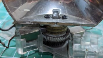

Glad you have a direction to take things. Here are some picture of the failures of Whelen's oscillating products and how their "brushed" rotators avoided theses failures.
Pierce alert "pivot point" wire failures
The rotators of the time (during pierce alert production) were first "brushed" where the bulb moved in the reflector like the pierce alert, and then brushless with a stationary bulb.
PXL_20230314_185643574.jpgPXL_20230314_185656881.PORTRAIT.jpgPXL_20230314_185702775.PORTRAIT.jpg
The brushed rotators did fail at the brushes occasionally, but not nearly as fast as the pierce alerts did at the wires. The brushes allowed the bulb and wires to spin without the wires being twisted or themselves spun. Had Whelen used brushes on the oscillating mechanisms I think we could have avoided failures. However, the cost and space of the brushes probably made them not worth the bother.

Replace wire even if it looks ok. Mine was twisted to death internally way below where the heat damage was. I just did all new flexible wire and found some of the right connections in my bin, but I had already done the amp connection trick so I left it. Good luck, post your results.

I planned on replacing all the wire in the pierce alert housing. It’s all toast. I am surprised it didn’t short out after pulling the housing off the bar and looking at it. I have fired it up a few times previous to pulling it out and was shocked at how bad the wiring was fried.
I ordered some 16g flexible wire that I found. Started to take it apart to re-wire it, and found out that the OD of two cables is too big for the routing through the base. So I will have to find some 18g that matches the flexibility. I will be sure to take some pics and post results. No promise as to how long that will be.
