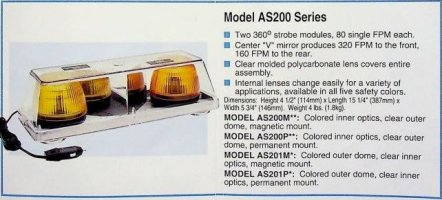

Here are all the models I can find documented for responder mini lightbars.

Responder "I" (there was no actual 1) was the "beacon", responder II was the first minibar (debuting in the early 1980s) and went through two dome and two rotator types while still being called responder II and respond-a-strobe, those being the only two models Whelen released in the smaller dome. Austin Electronics had a few variations in the later smaller dome style but their numbering remained more similar throughout all dome and rotator styles (see more below). The "dx" was simply the move to the larger dome (in 1995) that supported the two styles of advantedge rotators (and later a 4500 / delta style rotator) and model numbers started being assigned to the new versions being offered in numeric order. Model number r2dx was for the 2 rotator version. The 3 rotator version was r3dx and respond-a-strobe was r4dx at that time. Later when the dual strobe version arrived (around the time of the new advantedge rotators) it was dubbed "5dx". Much later at the end of the bar's lifespan the rotators were updated again and so were the strobes and the R6dx was offered which was the 5dx with updated strobes. A "heavy duty" metal base was offered and added "HD" to the model number. If you note a "M" or "P" attached to the model that was for magnet and permanent mount designation. The model numbers remained pretty consistent on the Whelen side even when the LED versions arrived (using the HD model prefix due to base style) in the 2007/2008 (Austin designation had been dropped in 1999). The rotator version was phased out somewhat recently, the guardian bar used larger rotators and carried the halogen rotating torch for a bit too.
Other models were offered via Austin Electronics primarily in amber. Their model numbers started with "AR" and "AS" depending on whether the bar was mostly rotators or strobes. The numbers loosely followed the number of internal components, in increments of 100, 200 and 300 but with some variations in the exact numbering when they deviated from what Whelen offered or when rotator types changed. The "DX change" at Austin simply changed the AR200 to the AR201. The next rotator change made the model number change again to AR302. Austin changes usually resulted in a numeric change in the ones place of the model number or an S in place of an R (strobe or rotator). You can essentially say that Austin Electronics offered Whelen's base model plus their own variations mostly utilizing their own model self contained 1000 strobe in place of the strobe portion Whelen was offering at the time. Post 1999 Austin Electronics was no longer the designation for the Whelen amber line and the offerings all merged back into one Whelen product line.
You can find exceptions digging through Austin literature but for the most part this is an accurate breakdown of what various model designations mean.

I think I'm down to just needing this one.... maybe another I missed based on rotator style.
