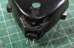

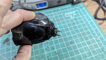

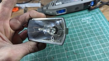

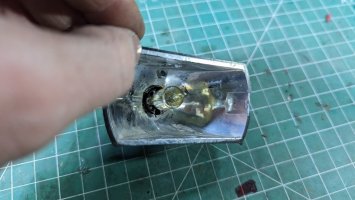

So..... I have figured out that you can make the "non-replaceable" ones relampable. I removed the pinned bulb from a H27SN and H50SN bu heating up the pins and melting the solder. I then had a pinned bulb and a shell of the snap in part. I drilled out the reflector and liquid plastic-ed the SN bse into the hole. Then I was able to slip the pinned bulb, or any pinned bulb i liked through the holes and bend the pins.
I made a short video of the process. Probably no worth the time, but I felt the reflector had challenged me.
I will upload the video when it is done.

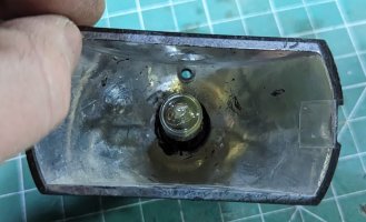

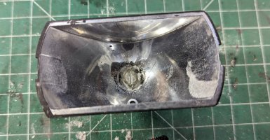

I made some revisions so that the bulb sits in the right focal point of the reflector. I also destroyed another already bad reflector along the way.rev1.jpgrev2.jpgPXL_20230509_191951990.jpg
PXL_20230509_192318354.jpgPXL_20230509_192325120.jpgPXL_20230509_193221852.jpgrev11.jpg
Once the plastic dries I will test the light pattern and distribution.

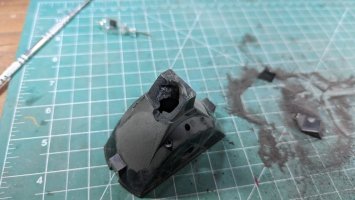

I can provide a few tips:
- Extract / break the old bulb first, then make your mounting hole. It's going to break either way, you might as well have control over when and in what direction.
- Wear eye protection. Seriously, don't just squint. No really, I wore eye protection and I typically use the "squint and look away" method.
- Take your time and expect a dusty mess. The dust made by the plastic housing and ceramic bulb socket taste like cancer and make sharp snot later. Wear breathing protection.
- I used a dremel and a drill. A cut-off disc and sanding drum for dremel and smaller bit then unibit on the drill.
- The back rectangle piece will disintegrate / fracture and is in the way for using other bulbs. Dremel it off unless you can cleanly drill it with gradually increasing bit sizes. If the breaks it takes the reflector with it.
- Liquid "high temp" electrical plastic / tape /sealer seems to hold the bulbs fine. I ran one 3 hours with no melting or problems. There are a few brands of liquid electrical tape and plastic. Both types (rigid and softer) worked. I used this instead of the epoxy that I thought of first. Temp rating matters.
- 27w bulbs are plenty. I suggest a H27SN bulb, vertical filament. Leave it in the base, cut the tabs off, make a hole the size of the base, and give yourself room to come forwards and backwards with placement. If you make a better sized hole you will use much less liquid plastic.
- Pay attention to the focal point of the reflector. My first attempt the bulb protruded too much. The original bulbs sit back in a bit. Thi is why I think anything over 27w will be trouble heat-wise.
- Take your time and expect a dust/glass/misc mess.

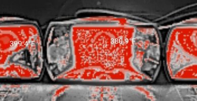

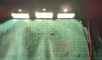

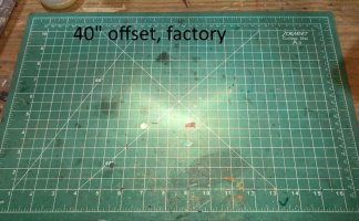

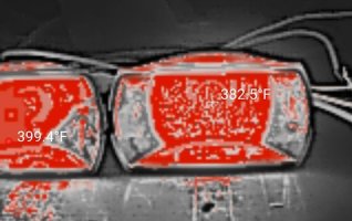

Final versions, plastic all set.
I tried to keep distances the same, but I moved a bit. It's close. There wasn't much variation between the replacements or the factory.
PXL_20230510_233020478.MP.jpgPXL_20230510_233022393.jpgPXL_20230510_233100019.jpgPXL_20230510_233102318.jpgPXL_20230510_233130766.jpgPXL_20230510_233134311.jpgPXL_20230510_233135767.jpg
PXL_20230510_233435294.jpg1683761740007_100.JPG1683761734840_100.JPG1683761745784_100.JPG1683761857306_100.JPG1683761912294_100.JPGPXL_20230510_233920138.jpg

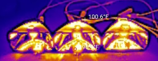

No difference in external or internal heat after 30 min. They look pretty much the same to me.
