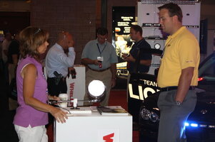

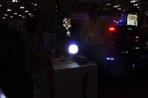

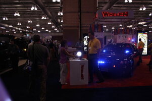

I attended the Nj Police Expo yesterday. Many of New products were there including the Led Spot light. I have several pictures I took of this product as well as other products that were just released. I will say this light is super bright and will be very worth the money for it. Warnock Fleet out of Northeren Jersey stated the product will be around $200-$225 and takes about an 1 hour to install.

I completely agree!
