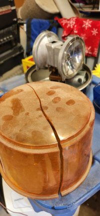

Got this in the shop yesterday. Looking for a red dome for it. Scratches or needing buffed up is fine. Not looking for perfect, just usable. No cracks. Crazing ok. As long as it fits the base...
