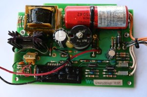

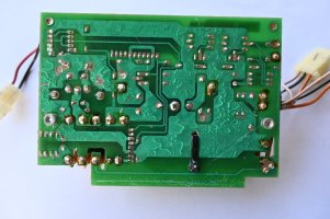

Here's the front and rear views of the P/S. The 12V Cig plug fuse meters out Ok.
I'll re-verify 12V Cig Plug polarity, as someone has replaced the OEM plug.
I tried applying power to the P/S...
