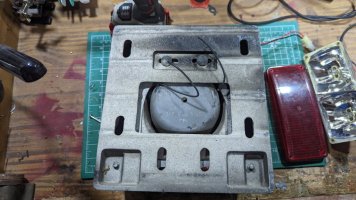

I just picked up this ex-ambulance. I wanna take the lights out and put them in my tow truck and get them working again. I have no control box and am in the process of uninstalling them. I have one out so far and there's no part number or serial number anywhere to be seen. Can anyone identify these light/siren combo pods for me or have any information about them?

Yeah, CPI speaker combo with twin "halo beam" mini max lights. These came in dual strobe, dual halogen/incandescent, and combo. They went by a few names; twin sidebeam, minimax, or halobeam. You will have a dual reflector with both halogen bulbs likely wired together. The quality of the reflector is likely to be faded or flaked off. The lights were powered by an ambulance flasher, they will be tough to remount without a mount other than the speaker. They would flash with any alternating flasher.
You can separate the bulbs and flash them as a split lighthead. The bumper / pedestal mount for 73/700 series will fit them.
The four screws at the corner of the lens will remove the light. The speaker is bracketed into the front of the truck where they cut the grill, usually pretty significantly.
I'm not sure how effective the lights would be for current warning applications. If they have good bulbs AND good reflector material, they might be usable. The bulbs are "pin style" and run about $15-20. The lamps were often replaced as a whole unit, reflector and all.
The speakers are likely heavy atlas 100 watt drivers with four bolts securing them in their housing. They were kind of a pain to remove, the bolts snap usually.

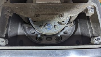

I had it out today but decided to put it all back as I couldn't get the speaker out. There's just a single 2 wire plug going to the lights. Red/black wires. The siren has a black and a white wire going to it but that's all there is.

These speakers are very vehicle specific, they offered them by truck model and year. There are 4 major parts; the speaker driver, the light, the mounts, and the metal housing which acts as the speaker housing. I would consider them pretty tough to port over to a new vehicle, but a cool item. The single set of wires for each portion (light and speaker) is pretty standard. You could split the light at the bulbs but I wouldn't bother, the factory combination process makes the connections tight and brittle and they look better grouped. As far as lenses, 7E (a brief version of the 7x3 light in between the 73 and 700) had lenses the same shape and size. The 73 and 700 series don't technically fit. You will need either the correct lenses or 7E lenses. Amber is moderately rare because these were usually red, but they are out there from rear ambulance mounting and a few DOT setups. I have seen some clear lately too.

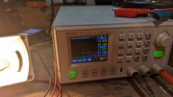

Ok... dug my own out.
Amp draw steady on (newer lamps) 4.23 steady, 4.85 peak startup
Amp draw steady on older lamps, 3.18 steady 3.9 power on
A good flasher for this. It can do 160 watts per side, you would only have 50-60 watts per side at 12vdc.
The amp draw while flashing (not much higher than the highest lamp's steady draw)
