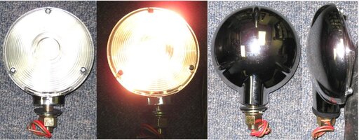

Federal offered these flashing lights in their August, 1975 price list, but grille lights of that era were typically single-side turn signals.
Flashing lights rear.jpg[/attachment:wv5gwc6h]
Around here, grille lights in the 1970's were pretty much all single sided universal turn signals similar to these, but usually with gray or black housings.
These were also popular around here when police departments began putting lights on the package shelf of their patrol cars.
Georgia State Patrol had the pedestal turn signals mounted on the rear of their roofs. Some Ohio State Patrol units in the early part of that era were slicktops and had them mounted on the rear of the hood as their forward waring.
Alot of Agencies in WV. had the lollipops in the rear shelf and on the bumper in the 70-80s .Actually had 4 mounted on a crossbar with a signal stat beacon on my squad before I put a Twinsonic on it.
