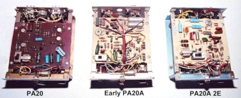

I've got all three versions of the 'blue face' Interceptor, and they all sound different. I use a 9 volt battery to test them without a speaker. The siren tones can be heard faintly through the circuit board and transformer.
