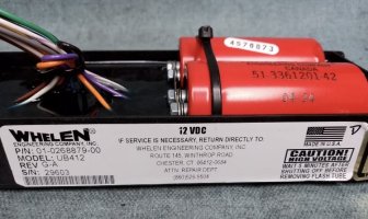

Just been looking at the wiring and noticed the unit I purchased has an orange wire but there isn’t any orange on the wiring diagram I found on another thread here. Not sure on the difference?
My flash tube has orange, black and white wires so just trying to figure out which one is cathode, anode and trigger?!

Me too ... my unit has an orange wire.
From what I see, YELLOW activates ports 1 & 4
Orange activates 2 & 3
Of the four strobe outlets leaving the power supply, looks like mine has hand-written number on each AMP connector:
PORT# WIRE COLORS:
1 BRN/BLK/GRN
2 RED/BKK/BLU
3 ORG/BLK+WHT/VIO
4 YEL/BLK+WHT/GRY
You have one big plug with 12 pins...mine has three four independent 3-pin connectors.
At this point, I'd trust the "IMG_5476.jpg" you have.
I don't have the part numbers handy bug I definately ordered the right 12-pin male/female AMP connectors from digikey in the past.
Where you say, "My flash tube has orange, black and white wires" -- I'd "assume":
BLK is CATHODE/GND
ORG is ANODE (should measure ~+500VDC relative to GND)
WHT trigger wire.
If you're not clear on what the trigger wire does, google "understanding xenon trigger transformer" and make sure you understand it...others explain it 100 times better than I can.
BOTTOM LINE: you _don't_ want to confuse your trigger wire with your anode wire!
HTH

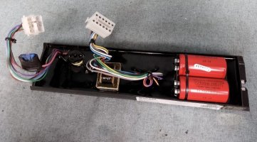

Sorry for the delay! I had to fight my computers to offer this:1773258491898.png
Port#1 is out of view as it is connected to the F-HEAD (and still flashing!)
Might not be helpful but this _is_ my UB412 as I purchased it (these port numbers were hand-written when I received it).
Based on the date-codes stamps on the big red capacitors:
Yours: "04-34" - made in the 34th week of 2004
Mine: "02-51" - made in the 51st week of 2002
