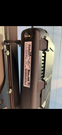

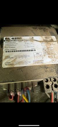

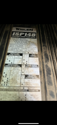

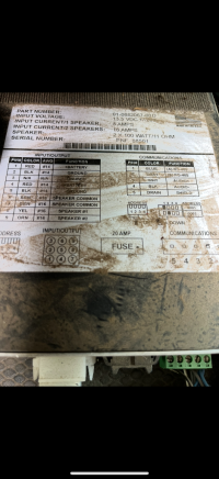

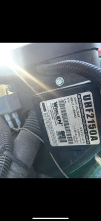

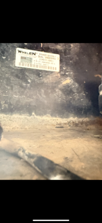

Can anyone help me figure out the the best path forward into getting this system back online or perhaps replacing it with something more modern. I have some ideas if that’s the case. I have been looking at a PCCS9LW paired with either a 48 inch legacy or senator system paired with a Whelen 295HFSC9 dual tone siren control. I’ve included photos of my currently disabled set up and remaining gear. The light bare is a b-link edge 9000 and the perimeter flashers are series 500, with two talon dash or in this case rear view flashers. There are also some small Whelen flasher on the wheel well trim.
Honestly, the b-link system was a good system… you’ve got some leds in the 500 series in the grill and at least one pair of 400 series 6 over 6 leds in the bar… I think I’d clean up the lenses and function check everything and see what it’s lacking… but it looks like a decent setup and was sufficient for its previous owner… the flasher in the wheel well is for the headlights. Youd need a MPC01 or MPC03 control head to run everything and all programming is done and housed in the control head. Looks like you’ve got one siren amp and the high power switch so you’ve got all the components and ability to expand as long as you can program it.

Would I only need the software and control head?
Theoretically, just the control head n software. But I’m not looking at your truck… seems kinda silly to sell the truck without the control head n leave all the lights. Can’t help but wonder if the control head got stashed somewhere to “disable” the lights n siren.

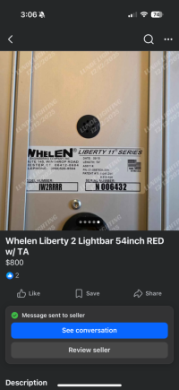

I purchased a wcc92 and I’m looking to get a liberty 2 or legacy.

That’s going to be a sharp-looking setup. Just a heads-up before you pull the trigger on the bar, The WCC92 is a serial controller, so you’ll need to make sure the Liberty II or Legacy you buy matches that communication style.
Low current control uses a number of trigger wires. Individual functions are enabled by supplying power to that option's trigger wire. No specific controller is required; switches supplied by the installer are sufficient. Low current control is a kind of electrical control.
Serial control uses a pair of wires that carry only data. A specific controller is required. The controller encodes the operator's control inputs into data which it then transmits down that pair of wires to a control board inside of the light bar. The control board receives and decodes the data and enables or disables individual functions accordingly. Serial control is a kind of electronic control.
