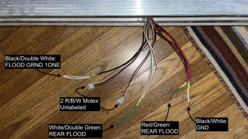

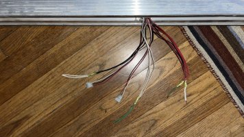

I have this nice Whelen 4500-series (maybe 5000-series) build-a-bar lightbar I won at auction a few years back. After sitting in the garage for a few years I'd like to get it running. I'm a newbie when it comes to lightbars but I have hobbyist electric skills (soldering, splicing, multimeter-ing).
Looking for some pointers on how to get this thing running. I've attatched a picture of the spliced wires coming out the back, some of them are labelled but I'm not sure how to power them. Do I need a control box? Can I hook it up to a transformer? Looking for any and all technical manuals/tips/pointers/anecdotes/etc.

The 4500 Super AdvantEdge has endcaps that wrap around into end lenses, and it has lens dividers that are held on with screws. This is not a 4500 bar.
You will need a strobe power supply for the three strobe lights. If you can find one the Whelen isp94 was always a favorite of mine and quite bright.
You’ll need some strobe cable extensions and a place to mount the PS, but would add another layer of affect at a party.
If you’ve got anyone prone to seizures at your party, may wanna hold off running the bar as all the flashes particularly up close can induce seizures.
