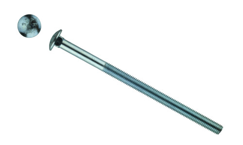

I have seen long bolts/threaded rods from the gutter hook to the bar used. Can't say I would trust or want the liability of magnets on a fullsize bar. Maybe for a parade but not for shuttling to or from the route.

Long carriage bolts have been used for extending clamps. I can't say they are my first choice, but I have personally seen some so long I wonder where they were purchased.
