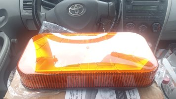

I found and purchased a Star Contour 9100 mini led bar with vacuum and magnet mount. Has a cig plug with power rocker and momentary switch for pattern select. This is new old stock I got for 100 bucks, good deal

I tried it quick taps, slight taps all the ways I could and nothing happens. Just 4 patterns out of said 20. I get a wig wag and full bar flash with two intensities of each.
Kinda frustrating, this bar is brand new and it says it does 20 patterns and it won't. Guess it's a dud.
I wanted a soft flash without the flicker, kinda like a cars caution lights, for snow storm lighting, but this thing looks like I'm going on a fire call or code three emergency. The patterns I do get are very aggressive

Someone here said you have to open it up to switch to different patterns. Must be the dip switch thing is true. No matter what I do, I only have 4 patterns. I tried to get the dome off, but don't see how .
While it is a bright light, it is built on the cheap side even though they sell for around 256-300 dollars or so. The base is plastic, dome can't be removed it seems and it has. Cig plug. I just don't see that price and I'm glad I payed only 100.
