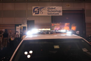

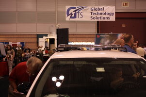

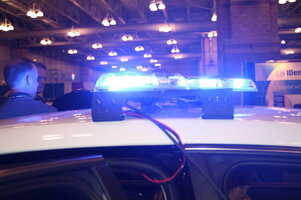

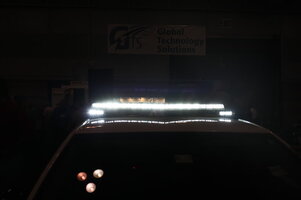

This product was also at the Nj State Expo. It is very bright. You have the feature of using the take down with just "4" led mod's with both the hot foot set-up and 2 mods in the lightbar. The bar also has the feature of using all the front leds as takedown lights. All I will say is wow. Federal Signal said the bar will be around $1200 or so. He said it will be very affordable even with multi color set-up.
ai133.photobucket.com_albums_q48_ff168577_091.jpg with the hot foot set-up
ai133.photobucket.com_albums_q48_ff168577_090.jpg with all forward facing leds as takedown lights.
ai133.photobucket.com_albums_q48_ff168577_111.jpg-side view in blue with night shot.
ai133.photobucket.com_albums_q48_ff168577_106.jpg- side view without lights.
ai133.photobucket.com_albums_q48_ff168577_104.jpg front view
