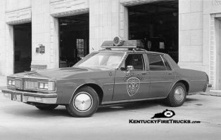

Louisville Fire played with Qs on Model 11s for a while then switched to something similar to JCPD. (Photos from KentuckyFireTrucks.com) They put them on bars b/c the hood hinges/springs were too flimsy to support the weight.
8E0F7ED2-7CF9-4B4F-9B28-8B8D1868A9BB.jpeg 709E395A-1BC6-4108-9DBA-87D1587D2A33.jpeg
The Olds was diesel…this is Batallion 2’s car, Maj Bud Fedeke (housed with Engine 5 and Snorkle 2 on Jefferson Street). He was a day staff on my volunteer fire department when he was captain and taught me quite a bit—an outstanding gentleman and firefighter.
View attachment 234843 View attachment 234844
I stand corrected on the model. 40 years has taken a toll on my memory. Thanks for the pics, Maxim2Eng, and the trip down memory lane. Outstanding!

I forgot to mention the cars all had massive Leece Neville alternators installed in them (200+ amps). The lights never dimmed…ever!
