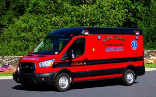

Link didn't work for me. Here is what I think you're referring to:Block Island Rescue 2 2023.jpg
And yes, definitely is interesting with the interior lightbar and no lightbar
NPS Ranger
1,989
Penn's Woods
The KKK spec never called for a lightbar. However, I'm not sure that windshield-mounted warning lights meet the current spec for upper-level warning devices:
