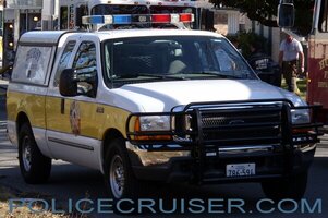

I'd love to go Oddyssey, the fire department did, has some nice Suburban 2500s. Money will not be there. I like the white/yellow F350 pictured. Was thinking that in crewcab, same type of cap, with the swing up doors. Put secure compartments behind those, and the extend-a bed in the rear.
