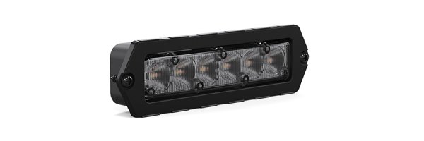

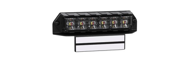

Was looking on the Feniex site again and found some new additions for mounting. I'm glad the finally did a flush mount. It took them long enough. Plus they now have 2 new window mounts with probably 3M tape on it. It also appears that they've completely removed the T6's from the website, but they have kept the Apollo's. So I'm assuming anyone who wants T6's will only have a limited time to get them. Now if I could only get mine in... Still waiting...
awww.feniex.com_product_pictures_83632Fusion_20window_20surface_20mount2_head.jpgawww.feniex.com_product_pictures_26555Fusion_20window_20lightstick_20mount1_head.jpg

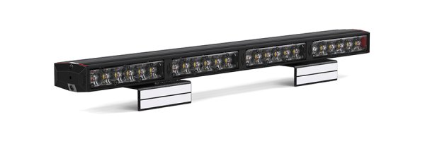

Here's the new Fusion visor bar that just arrived today. All 40 degree R/W's. Installation coming this weekend.
That looks nice! I'm trying to decide if I'm going to replace mine Cobra ILB with 40 degree optics or a mix of both. Or just got full size bar. To many choices now!! Looking forward to seeing your installation!!
