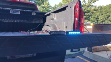

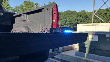

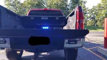

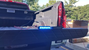

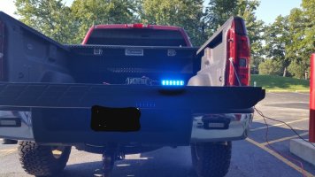

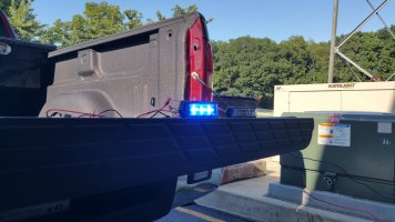

For those who want a side by side comparison. Here's the best I could do on my phone camera. Compared is a Fusion 40 and a 2014 T6 blue, without the revised optics. The other is a 2016 Apollo blue vs the Fusion 180. Both the Fusions are blue/white, but I only have single colored Apollos to test at the moment. I'll give my thoughts after the pictures.
T6 vs 40 degree Fusion / Blue Only
Apollo vs 180 degree Fusion / Blue Only
Apollo vs 180 degree Fusion - Off Axis / Blue Only
Thoughts T6 vs 40 degree Fusion:
The T6 Cobra seems to fill out the entire lens just a bit better, however this really makes no difference once you stand back a few feet. They appear to be just about the same brightness, if not the Fusion is just a tad brighter. Its hard to tell. This may be due to how the leds are mounted on the board, making room for 2 sets of leds per TIR optic. However, on single color Fusion 40's, I'm not sure how they mount the led, so I don't know if it changes how it looks. Does this make it bad? Absolutely not. And with the Fusion offering dual color dual mode, that definitely adds a great value with TIR optics.
Thoughts Apollo vs 180 degree Fusion:
The new optics make all the difference. Feniex took the frosted section out of the hour glass and made it clear and it seems to have made the Fusion better. It's hard to capture on camera, but the Fusion does look great in direct sun light and holds its own against the cobra at distance. Off axis appears to be better too, with the frosted center removed, as I noticed stronger/brighter light coming from the center as I moved to extreme angles. Better than the original Apollo. However, on the flip side, the original Apollo seems to fill the whole housing with light just a smidgen better than the Fusion 180. This, I believe is due to the removal of the frosted center. This only really shows when at the full 180 and is very minor. That is my opinion as my eyes see it. The Fusion 180 doesn't perform bad by any means and this is just my subjective opinion. Also, I feel that the dimensions of the Apollo vs Fusion 180 also have their place too. Being that the Apollo is shorter in length, if can fit some places the Fusion 180 can't. So the Apollo still has it's place in emergency vehicle lighting placement.
Thoughts 40 degree fusion vs 180 degree Fusion:
In direct sunlight from a distance at eye height, they almost appear to be the same brightness, but the 40 degree optic nudges it out by just a hair in brightness. However where the 180 shines is when you start moving off axis the 180 degree optic appears to maintain most of it brightness until you get to extreme angles. As its designed to do, it has fantastic off axis abilities. (Kind of a "duh" statement, I know) The Fusion 40 definitely loses is punch, as do all TIR's when you get to 45 degrees and more. However, when you get all the way to the side, you do have some off axis warning with this new style housing. But, obviously not as good at the Fusion 180.
