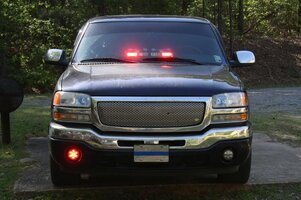

Whelen 200 Series TIR6 PAR36 LEDs + GM OEM foglamp housings
Has anyone successfully replaced their GM (Yukon/Tahoe/Suburban/Sierra/Silverado/etc) OEM fog lamps with Whelen 200 series PAR36 TIR6 LEDs?
I've been told by several professional upfitters to get the Charger mounting kit and customize it to my needs but, I've also been told that the big W doesn't sell "just the kits". They will however sell me the "needed" parts for right at $100 :eek: . Still, these parts would be for a Charger and not a GM truck.
Has anyone made it work? How did you do it? Pics would be great. I will probably update this thread with more info and pics as it becomes available.

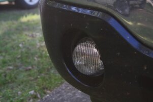

Pimpala03 02-25-2009 08:41 AM
Pics to show what I'm working with...

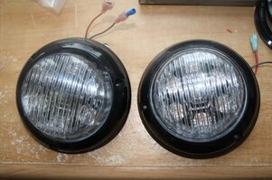

Pimpala03 02-25-2009 09:27 AM
And here's what the lights look like, for reference:

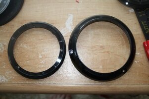

Pimpala03 02-25-2009 11:56 PM
Upon cajunblitz's request I took a picture to show the size difference. The picture makes it look a bit more extreme than it is but, there is still a significan difference.

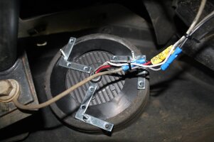

Pimpala03 04-06-2009 05:01 PM
Here's what I did...
I found some angle braces at none other than Wal Mart. Believe it or not, it holds these suckers on there tight. They ain't gonna budge. Instead of using the screws that came with the flanges, I used some bolts that way I could tighten them down. It looks pretty good from the front and the back looks like mini swastikas but hell, it works fine. ;)
