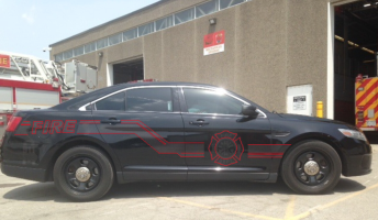

I would suggest that you make it the same scheme as normal PV but with bold lining and reflective Wrap. Or have the same scheme with different colors Like Red which stands out.
I’m not a fan of ghost graphics for fire/EMS vehicles. The purpose of them is for certain LE units to be more discreet in normal traffic but still marked when they pull someone over; IMO there’s no reason for stealth graphics on fire/EMS vehicles....either mark them with regular graphics or don’t mark them at all, but don’t be a tool and make it an all black install that makes it look like you’re a cop.
A fire admin vehicle can have a full graphics package with 360 striping, or (if it’s not a frontline unit responding to all calls) it can have a few basic graphics like the dept logo on the doors & liftgate and call it a day
Pdk... You're preaching to the choir, brother. I worked for an agency that had purchased a PIU as a chief's vehicle. Was all white, with silverleaf lettering. To top it off, they threw a FS Legend on the roof.... with red domes.
I wish I was making this up...
Reactions: prty
The OP said this was police.
How often would the chief respond to a scene?
No point spending money on fitting out a car that spends most of it's time as a commuter between home, the station and city hall.
If it's primarily a takehome/PR car then I'd keep is simple and classy. Grille/push bar lights, HLF, front visor light, sidekicks and a rear deck light. I wouldn't even bother with running a dual speaker siren. Select a sensible pattern and synch it all properly and use proper markings and it'll stand out and look classy.
Heck, if you haven't gotten the car yet I'd just order it with the Ford ready for the road lighting package and call it good.
Otherwise I'd just run the same setup the rest of the fleet has.
