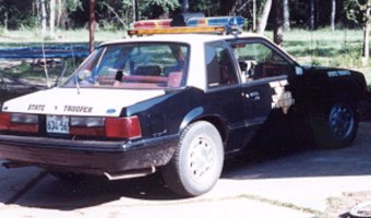

Thanks for the replies.
This is what I’m working with as a reference for my restoration to be 1993 period correct. These are actual images from the 1990’s showing TX used the Jetsonic w/ Code 3 ArrowStik. The images are of (4) different 1993 patrol units.
I just cannot see how Fleet Services did the AS mount to the Jetsonic in those 90’s images above. That’s also why I couldn’t tell if there were small bumper feet or pedestals under the AS, because it’s pretty close to the roof top.
With the images posted above by Benno and TDC, I now understand there was L brackets coming off of the ArrowStik.
