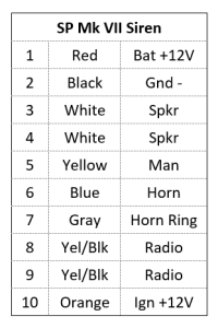

Sorry to necropost on such an old thread, but could I please have the Mark VII siren’s servicing manual? I’ve been looking to build one for a while, but information about SP sirens is near-impossible to find.
hi guys, the manual is uploaded in this thread:
Click the post that was linked above yours, part way down you will find the manual as a PDF.
