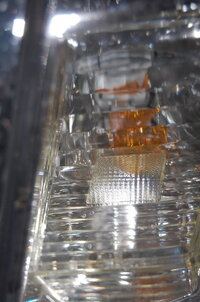

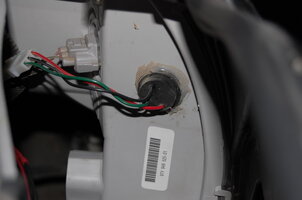

Reposting from the old board.
Grommet mount strobe tube HAW in front turn signal reflector. Gives great throw to the side for intersection warning. Can be drilled without having to remove the light housing from the vehicle. Use a vacuum to suck out any shavings but be careful not to push out the diffuser in the lens if you stick anything inside the hole to try and remove shavings. I sealed mine with clear silicone around the grommet and have had zero moisture problems even after DEEP water crossings, winter snow, etc.
CSP660 power supply with Sirennet tubes and cables controlled by Whelen Cencom Gold
- DH

Hi DH,
Thanx, from the picture i cant tell where or what direction the headlight is in the picture??
Nolo
