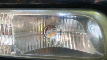

just wanted to throw this into the mix this is what i found to be good placement for haw on my 05 tahoe front.
the unused space on the corner, this give you great side coverage. pair of sos undercovers
next the drl housing im using a pair of feniex fairy so the top down mount works for me.

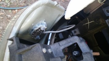

This is for the 1997-2003 Ford F-Series. My truck is a 1999.
Here is where I mounted the strobe in the corner lamp
Here is where I mounted the strobe in the taillight.
