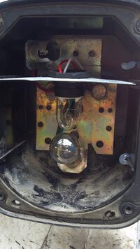

Here's how I mounted a HAW in a Jeep/Ford/GM/Peterbilt/etc. tail lamp. Pulled out the metal divider plate, drilled a hole, and popped the bulb in. I removed the reverse light bulb, as I was worried it could potentially get warm enough to damage the wires on the HAW, though I doubt it would really get that hot unless you were in reverse for a while. I also had to bend the brake/tail bulb down ever so slightly to fit the HAW. That said, the hole I drilled was a bit larger than 1", and thus the bulb sits down further than it would sit otherwise. If you drill a 1" hole, you may not have to bend the bulb out of the way. I kind of like having the HAW down lower, though, as it gets pretty close to the focal point of the brake lens.
Note: You could put the HAW through from the bottom, and have it sticking into the reverse light section, but I don't recommend it. That was my original intention here, but the bulb ended up way too close to the housing, even when moved down to the indented point on the base. LED HAWs should work though, assuming you're using something with a good horizontal spread (SoundOff Universal LED HAWs come to mind).

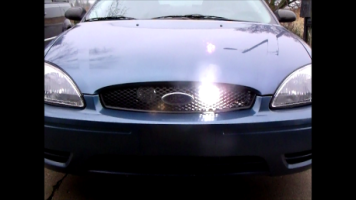

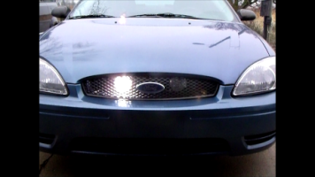

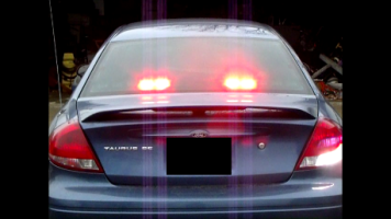

'04 Ford Taurus
In the rear there is a "blank" section of clear reverse light lens (the actual reverse light only uses a couple inches, and is blocked off from this "blank" section. When you pull the tail light casing out there's a flat spot that looks like it's darn near designed to accept a light right there.
In the front, it's a REAL pain in the butt to install them because of the design of the headlight casing (you can't get in there to drill into where the lights actually go, it's all encased in a shroud) so I ended up buying a cheapish (like $50) set of fog lamps, metal casing, glass lens, removed the bulb, modified the hole, and mounted the strobe, then I put them in the grill.
I realize putting the strobes in the grill totally eliminates intersection warning, however this car is a security company car and all they really wanted was that it be visible when sitting on the side of the road inside an apartment complex....guess they've had a bunch of cars smacked by people driving like idiots while their officers are on calls....
