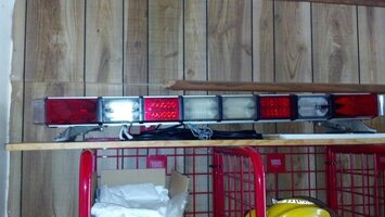

Well, I've done another upgrade. I'm donating this bar to my old FD back home in KY for their "new to them" engine.
This time I've started with a Whelen 9M eight strobe bar, which was originally eight strobes, TDs, alleys and rear flashers (w/TD flash capability) and gutted the halogens and corner strobes. Red Freedom corners went in the bar, with the four 400 series strobes facing to the front along with two 400 series six over six LEDs. Since this is going on an engine, the primary use of this bar will be to the front, hence all the warning concentrated there. Basically, it will be red LEDs and clear strobes.
I've got to cut some new lens sticks down to size and do some swapping of lenses on another bar, so this pic is the bar w/o lenses. I have clear 9M endcaps w/o alley cutouts in really good shape that I'd like to trade for some solid red 9M endcaps, if anybody is interested.
Reactions: StEaLtH2
I love the idea of red LEDs and clear strobes. Nothing "pops" like a clear strobe and the warning power afforded by freedom corners and the 6 over 6 heads should balance it out nicely. Can't wait to see it with lenses.
Pretty cool. Is it a TA or just a warning bar?
Here's a pic of the bar with lenses. I need to polish the center clear lenses, but that's all that needs to be done. I want to change the endcaps to solid red, but I doubt that will happen any time soon. Perhaps I'll change them down the road, but it will be after I donate it and recoup some costs put into this upgrade.

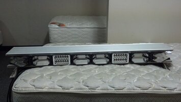

And my very own! This uses Whelen 700 series and Tomar RECT34 LEDs. They are all independent. I'm debating on whether to add a flasher or not in the future. As of now, the bar is only half done as I have only completed the front. The rear still has the original strobes. Complete with a Barker's beauty! Video to follow soon!
that jet looks pretty sweet! looks like a modern tomar 925!
