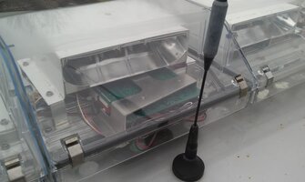

Whelen Mini Liberty. This one is complete. 4 corners, 6 LIN6s, flashed off a ULF44. New lens, with the exception of one used endcap and lens dividers (soon replaced). Mag mount with wiring to control power and pattern on one plug and override and low power momentary on the other. Magnetic mount.

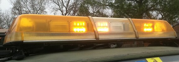

Well I have a Code 3 Excalibur that I added 6 Federal Signal Solaris Modules to the front and rear. Here are some pictures and videos of the finished product. Let me know what you guys think. I thought it came out pretty well.
Beautiful! I don't much like the flash pattern on the LEDs and I'd rather have the blue in the middle, just for symmetry, but otherwise it's awesome!

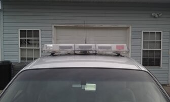

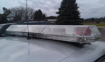

Here's the 3 minis I made, all together. The top, smallest one, now has new endcaps and dividers to replace the used, yellowed ones.
And the 3rd, the true micro mini Liberty w/ 4 corners only. It's what I was trying to accomplish with the middle all blue one, but didn't quite get it right. The difference in the two is the middle one has the black inner dummy power supply, while the smallest doesn't have one, it's held together by the corners and lenses only. Filler screws and nylock nuts are in the holes, but there's nothing there except the top plate. Unit is red/blue with LIN12 corners and 5mms in the endcaps and has a ULF28 flasher. Not sure I'm sold on the ULF28, I'll probably change it out for a DPS Freedom corner flasher, or a ULF44. I'll try and get a video when I get a chance.
ai667.photobucket.com_albums_vv36_rwo978_Projects_20Reviews_Custom_20Bars_th_MicroMiniLiberty.jpgai667.photobucket.com_albums_vv36_rwo978_Projects_20Reviews_Cub1b4856ad295170151bb062e9293478b.jpgai667.photobucket.com_albums_vv36_rwo978_Projects_20Reviews_Cu615a995326f8ee655affca552d2e5c9c.jpgai667.photobucket.com_albums_vv36_rwo978_Projects_20Reviews_Custom_20Bars_th_MicroMiniLibertyTop.jpgai667.photobucket.com_albums_vv36_rwo978_Projects_20Reviews_Cu809429554720cbfd0d62b614acb442c6.jpg
ai667.photobucket.com_albums_vv36_rwo978_Projects_20Reviews_Cu0ee6c56b305042332eb69d86bce3e2d0.jpg

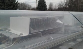

I've had several requests/questions on measurements for the large minibar, so here's a repost of a PM I sent.
Frame is 22 3/4 in, but you could probably get by with 22 1/2 in, or a tish longer. There's still room to squish the divider foam in more, so 1/4 inch overall, or 1/8 inch on each end isn't going to make a difference for lens length.
Lens sections - 5 inches for the 2 inner sections, 5 11/16 inches for the 2 outer/corner sections.
The top/small one, the frame is 10 3/8 inches and each of the lens sections are 5 inches.
