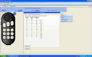

Ok, well this is my first How to Tutorial. Let me know how it is. If you need anything else let me know
Ok, well first to make the 2 T3 Tones, you will need to configure what button you want to have a siren tone. Now if you look at the Red circle

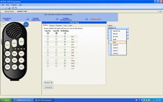

Now what you need is to Drag the Siren Option to the button you want.

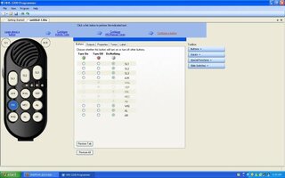

Now what you need to do is select the Tones Tab. Now you want to remove the Manual Over ride tone. Now you only need to do this if you dont have a Manual button, like mine. Then what you want to do is add the tone you want. Now you have a big list to choose from so have fun choosing.
And this is what mine looks like as of now. Any other questions feel free to ask. I will also be showing a video of how the unit works sometime today or tomorrow. I will also post a link. I wasnt able to find one on Youtube so I figured I would make one for everyone else to see.
