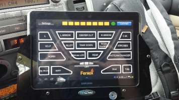

I love it. The mounting kit is vehicle specific and works really well. I put a small piece of foam on the dash so when the tab 2 is in there it doesn't move at all. I have positive pressure against the tablet. Also installed a blue seas dual port usb power point in the dash right behind it so I can keep it charged while running gps. Worth the money for vehicle specific mount

Its not suction cup. It is what I would call "permanent" mount. They have vehicle specific brackets that screw behind the dash and the dash assembles right back in place with no modification. It had very slight bouce so I put the pc of foam in there to eliminate it. I will take pics in the daylight

No apple products here, it is the Samsung Tab 2 10.1. Love it I have run it from inside my house to the truck 30 feet away. I will have to play and see how far the max is. My only gripe is the mode switch is progressive only. Meaning that it goes : stand by mode, 1, 2, 3, off. It would be nice if it was more like a slide switch. I dont need to run a siren all the time I cycle my lights. But I guess I could turn it off in mode 3 but that is response/pursuit mode.

Sorry, I didn't really look at the picture. I thought I remembered someone saying something an iPad and just assumed it was about your setup.
