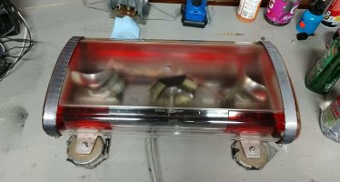

Small example of why I love to work with this stuff so much, just had one go at the MX dome on the right, it was as bad as the one on the left.
